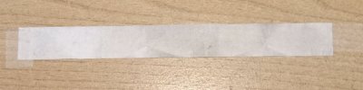

The chatter is while traveling and does not do it constantly.
Is there anything that would need lubricated. I did find this piece of waxy type paper at the far end of the travel for the print head. It is 5.5" long and not quite 5/8" wide.
