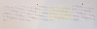

Hi, I am new here and am not overly experienced with printer issues!
I have a Ricoh Aficio SG 3110sg sublimation ink printer which I have used quite successfully to produce transfers for printing on tee shirts. That, however, was more than 2 years ago! I have recently started printing again and find that the colours on the printed sheet are less vibrant than they should be, even though I have run the print-head cleaning routine 3 times. I have run several print jobs through the printer and there has been no improvement. The ink, I have been using, is an after-market type used in conjunction with re-fillable tanks (the brand on the ink bottles is 'Refill Solution'). I am wondering whether the ink may have lost its intensity through sitting around for 2 years-or-more and whether I should empty the tanks and refill with fresh ink. I would also like to know whether there is a cleaning fluid I could run through the print-heads, via the ink tanks, before doing this. Your advice, please, folks!
Thanks, in anticipation
Clive

Does that printe rhave a nozzle test page? Can you print that and take a photo and post it here?

Hi. I printed the test page but when I attempted to upload an image of it here, I was informed the file-size was too large! Anyway the test-print shows 4 'ladder-type' panels of each colour in the order of cyan, black, yellow & magenta. The colours are all quite muted in intensity. Incidentally the ink-level indicator (on the front panel) shows that the black ink tank is low, even though I filled it.

PS. Regarding the test-print. Numbers are printed at the top of each 'colour ladder' in the following order Cyan 1, Black 1, Yellow 2 and Magenta 2

Hi Clive,
Thanks for the email. I have taken the liberty of scaling the image a little smaller and attaching it here. That way it's useful to everyone on the forum.
This print test was actually very useful. What the ladder is showing is each individual print head nozzle. The 1 and 2 are, I suspect the print head. Looks like Cyan and Black are on head #1, and Yellow and Magenta on head #2. Low intensity on your colours could have been clogged jets. It looks like all the jets are clear, which is good news.
So don't run any more print head cleaning routines. Your heads are fine. I wouldn't go so far yet as to try and clean out your inks. Your black and yellow both look more or less as I'd expect. Your cyan does look dark. I am wondering if some black ink mixed in and contaminated the head.
When a print head parks, ink jet printers put the print head on a sort of rubber cup that is intended to make a seal and keep it from drying. Over time, and is has been two years, some ink can flow out into that cup and mix. This doesn't appear to have happened on your #2 head, since any magenta in the yellow would be clearly evident. But your #1 head may have had some cross contamination - it's actually hard to tell from the photo, but the cyan looks dark. That could also just be the fact you are using dye sublimation ink, and it doesn't necessarily look great until after it's been heat transferred. If there is cross contamination you can try and flow it out by printing pages set up with large blocks of cyan and black.
When you do a heat transfer, what does it look like?

Apr 6, 2022
5
Va1der, I have now, as you suggested, carried out a test print on fabric. I find that, once the ink has been transferred from the sheet, the colour vibrancy on the garment is much better and, although not quite comparable with the original artwork, it is acceptable for purpose.
Many Thanks for your help!
