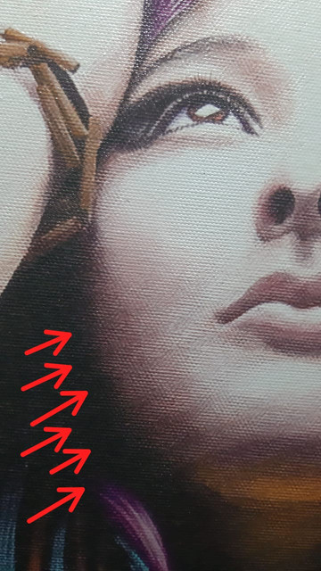

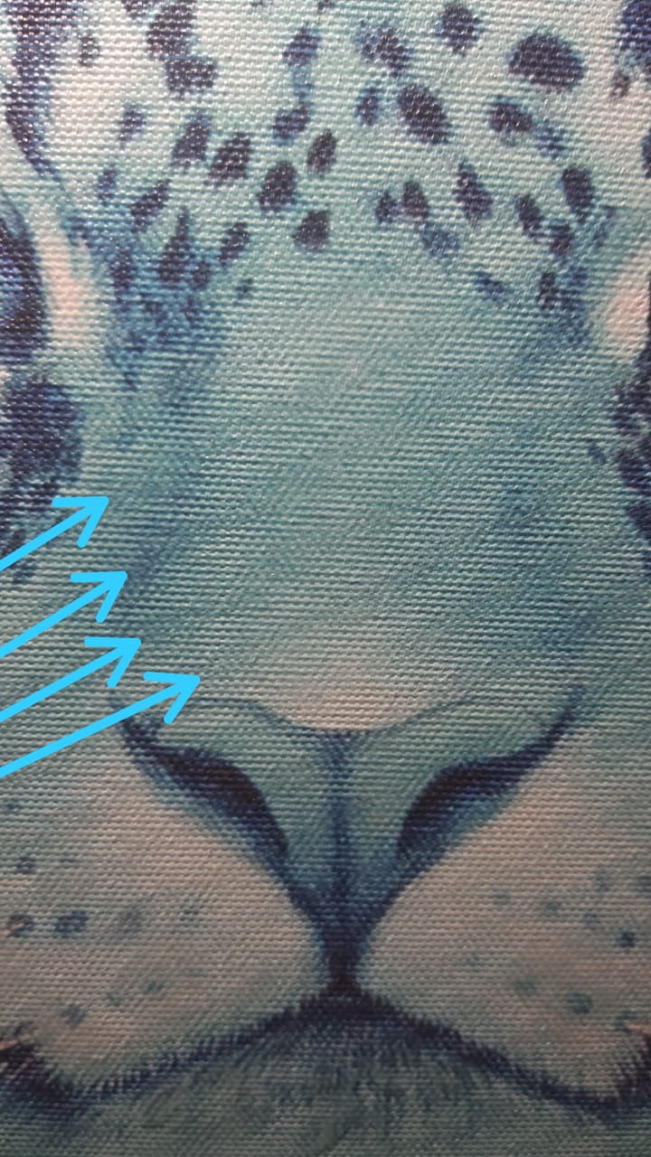

And these are actual photos of the bad print, which again don't capture how noticeable the banding actually is:
As a last note, notice the "dark bands" show a higher concentration of "ink / material deposited" and the "bright bands" show more the actual texture of the canvas, meaning that there was more ink deposited in the dark bands, which is what makes the other bands "appear brighter" - the canvas texture reflects the light on the faces of the weaving that face up, making these bands appear brighter than the other bands.
![Whats-App-Image-2019-03-26-at-7-02-41-PM.jpg](/proxy.php?image=https%3A%2F%2Fi.ibb.co%2FX8C8bz2%2FWhats-App-Image-2019-03-26-at-7-02-41-PM.jpg&hash=4827bf7164c466207b609bcec77ef80e)
![Whats-App-Image-2019-03-26-at-7-02-54-PM.jpg](/proxy.php?image=https%3A%2F%2Fi.ibb.co%2FCv7x8bR%2FWhats-App-Image-2019-03-26-at-7-02-54-PM.jpg&hash=d5fe8f16915b45bab84e6b18596345ef)
